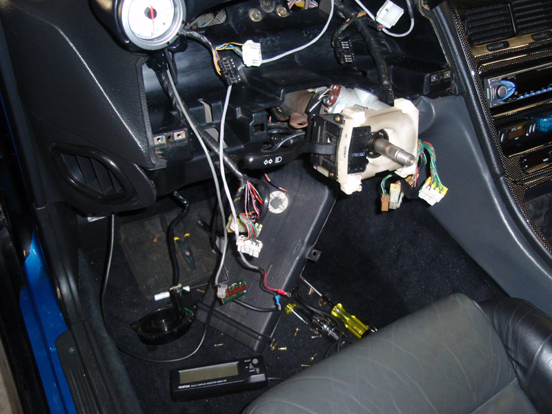

I opened up my 90' FSM to find it only seemed to have troubleshooting procedures for an NA speed control unit. My 91' FSM did have troubleshooting for the HICAS/Speed control unit but the color codes for the wires were off. There are a few signals that go to the speed control unit that will cause the hard steering problem. Here is a picture of the HICAS/Speed control unit.

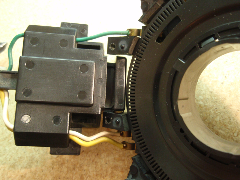

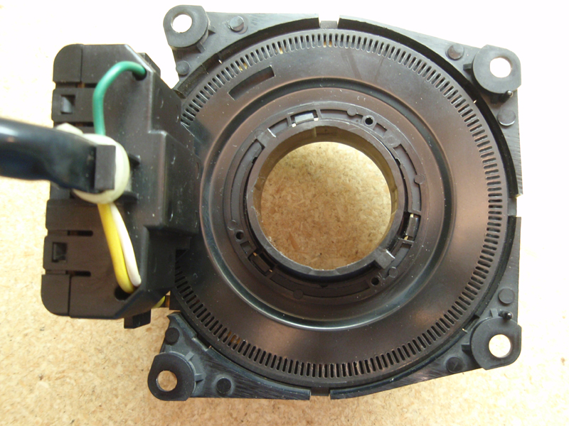

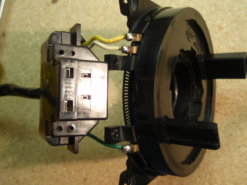

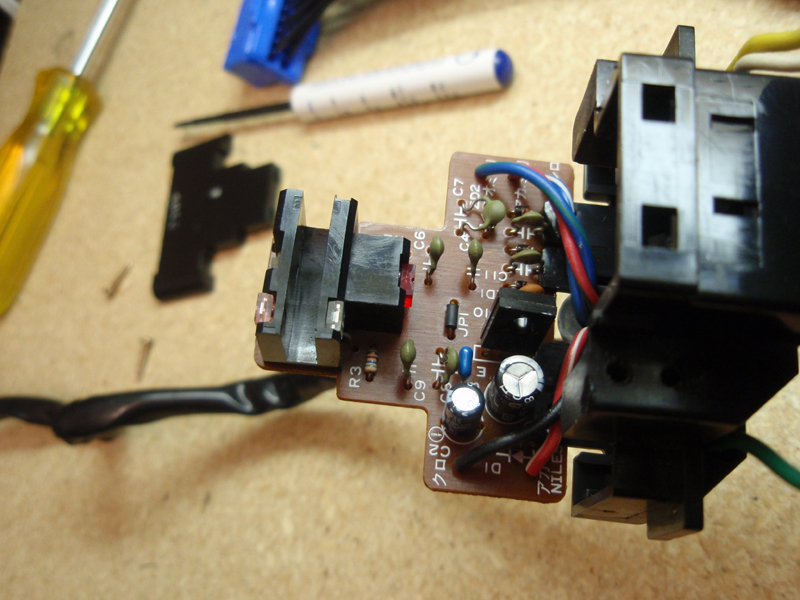

All the signals checked out so here is some info on how this works. Like I previously showed in my CAS repair write-up, the speed angle sensor also uses photo sensors and a slotted disc. Here is a picture of the back side (side farthest from the steering wheel) of the steering angle sensor. The tiny slotted holes send a pulsed signal while the steering wheel is being turned.
In this picture I have turned the disc slightly to show the one larger slotted hole. When positioned away from center this slot causes the steering angle sensor to send a constant five volt signal on one of the wires coming from it. It lets the HICAS/Speed control unit know that the wheel is turned from neutral.

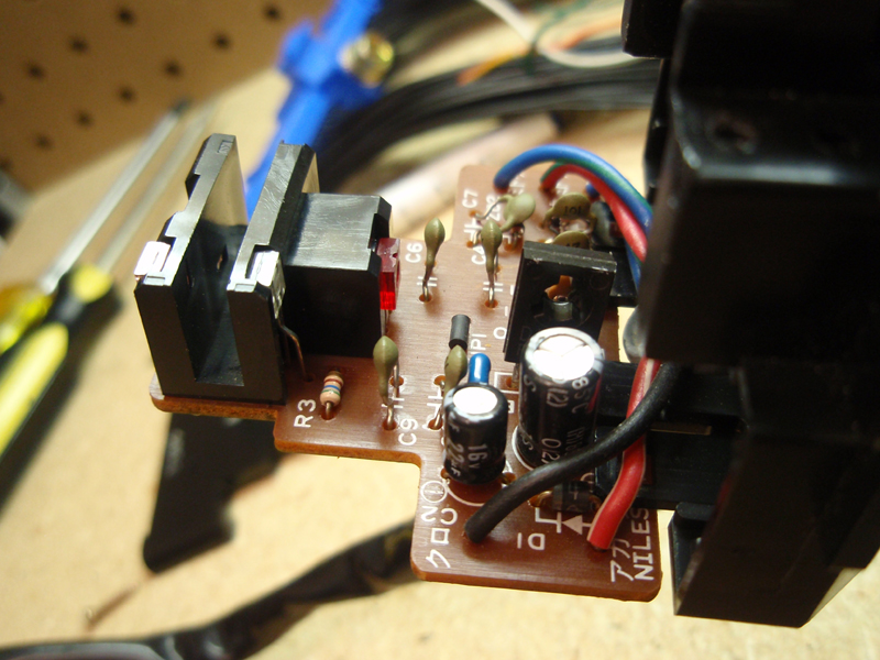

The piece attached to it with the two small screws contains the electronics and photo sensors.

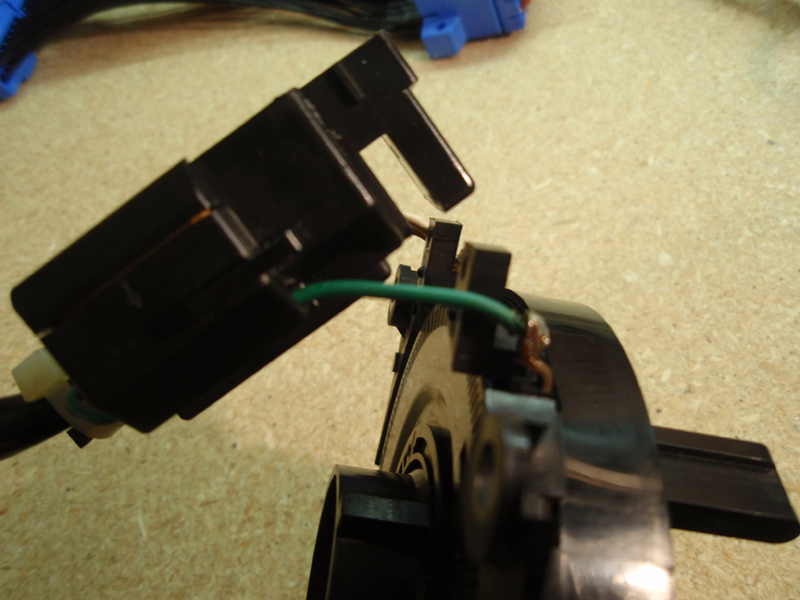

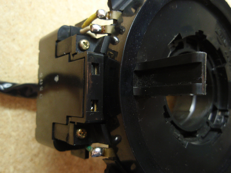

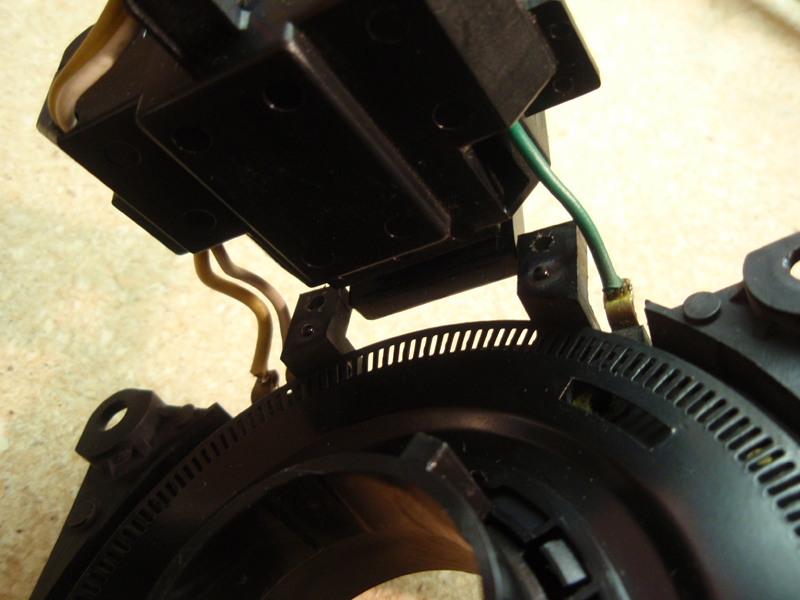

Some pictures of it unscrewed from the main unit.

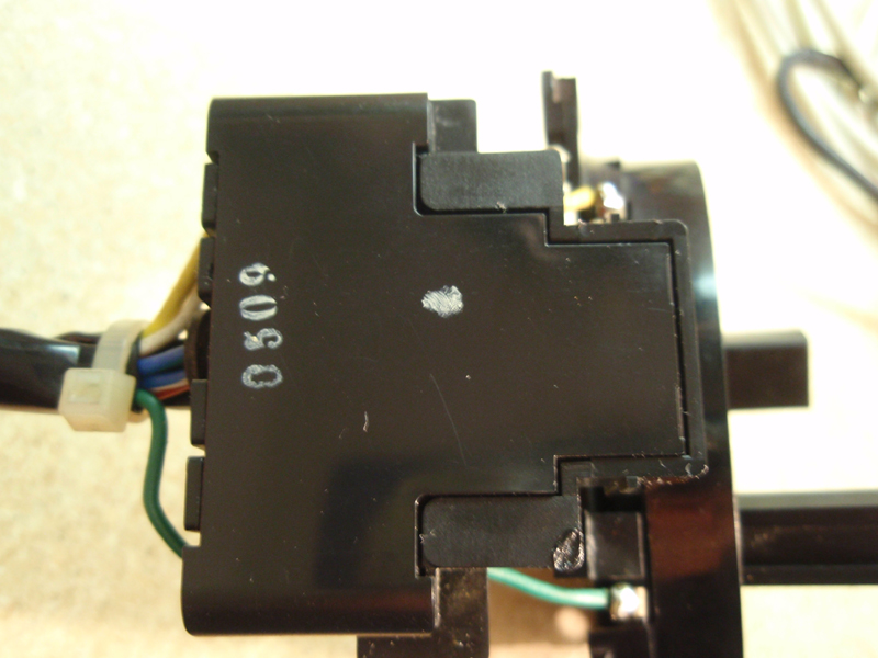

On one side there is a removable cover.

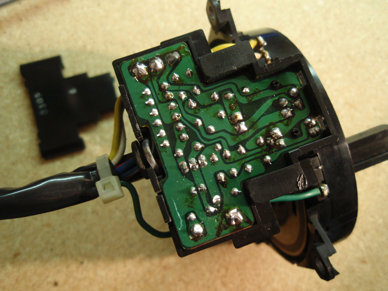

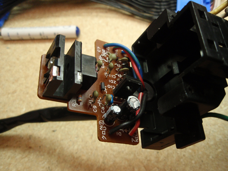

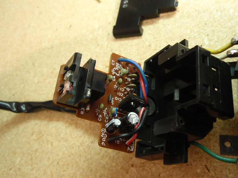

Cover removed. Yours may look a little different because I resoldered all the solder connection on mine. Bad solder connections are inherent on many of the circuit boards in our aging cars.

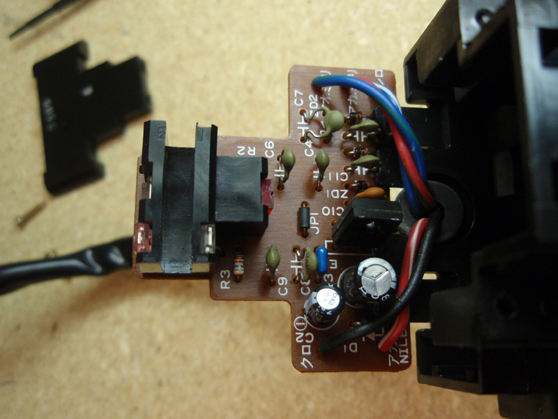

The circuit board out.

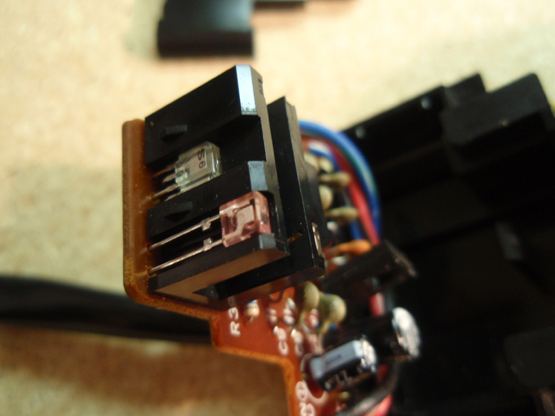

There are a total of four photo sensors or LEDs. Two transmitters and two receivers. When in place the disc spins between them.

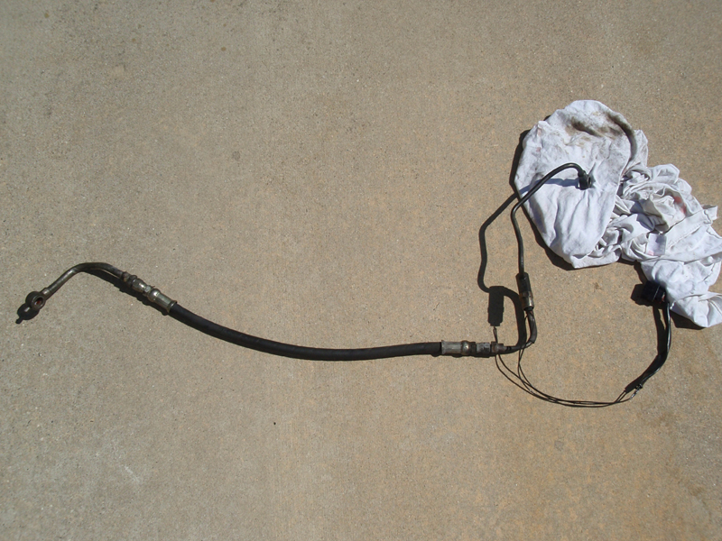

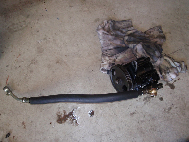

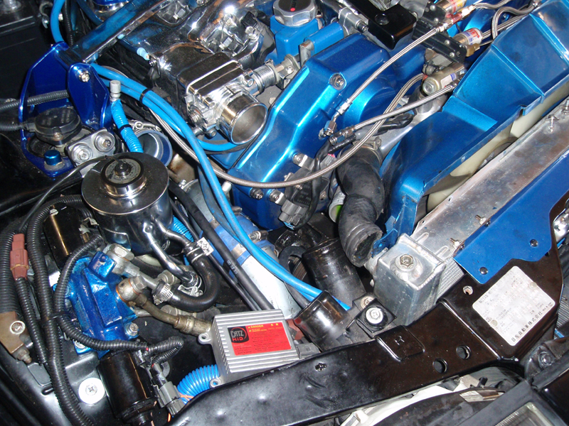

Anyway, here is where I am now. I'm still working on the problem, going now with my gut feeling as I should have in the beginning. At least I leaned a few things along the way. A few pics.
